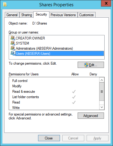

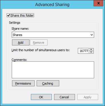

First, create a shared folder on the network, granting all clients "Read" permissions and "Read & Execute" NTFS permissions. For example, name this folder \SRVR2012\Shares, or use the server's IP address. Inside the "Shares" folder, create an "AIDA64" subfolder and copy the contents of the ZIP package downloaded from the AIDA64 website into this subfolder.
If you want to store reports in the "Shares" folder, set "Modify" permissions on this folder. Alternatively, you can create separate shared folders for the reports.
By appending a $ sign to the name of the "Shares" folder (e.g., "Shares$"), it becomes a hidden share. Using hidden shares is recommended to prevent users from uploading or deleting content, even if permissions are set too broadly.

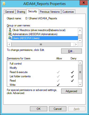

If you choose to store reports collected from client computers in individual files instead of a database, create a folder with "Write" NTFS permissions for all clients. For example, name this folder \SRVR2012\Shares\AIDA64_Reports. AIDA64 running on the clients will be able to copy the reports to this location. Ensure that any inherited "Read and Execute" permissions for clients are revoked.

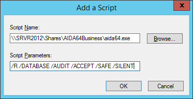

Run the Group Policy Management Console on the domain controller and navigate to the Group Policy Object group where you need to add a new GPO. Name it, for example, "AIDA64". Right-click on this entry, choose Edit, then navigate to User Configuration / Policies / Windows Settings or Computer Configuration / Policies / Windows Settings. In the Logon or Startup Properties dialog box, select "Add a Script" and add the full network path for aida64.exe (\SRVR2012\Shares\AIDA64\aida64.exe) along with the desired script parameters (/R /DATABASE /AUDIT /ACCEPT /SAFE /SILENT). This ensures that AIDA64 will run automatically and start creating reports on the client machines when they log on to the network or when they are turned on, depending on the script chosen.

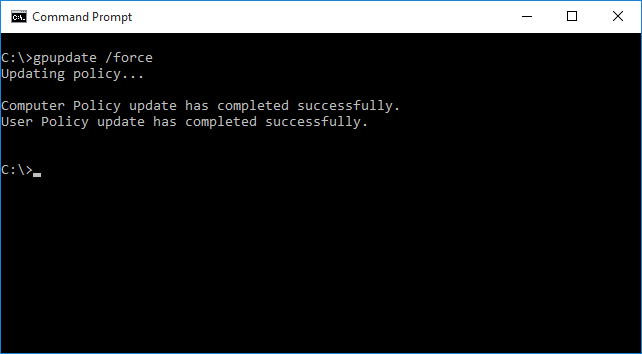

To immediately propagate modifications to all client computers, activate the settings using the “gpupdate /force” command. Then, use “gpresult /R” to check if all clients received the GPO. You can save the information displayed by “gpresult” to a file with “gpresult /X C:\report.xml”. For detailed information, use “gpresult /V”. For other available options, use “gpresult /?”.
